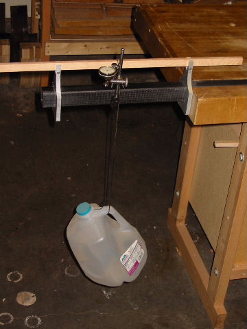

I was chewing on your comment on static testing and cold creep last night some and I’m not sure about it. I must confess I do static testing and I think I get very valuable information from it.
I think either way works as long as you are consistent with your method. The speed of sound “C” in your equations above I think have the biggest impact for us. Just my opinion. So any method I use to obtain E as long as it’s repeatable, will accurately grade my wood in terms of stiffness and speed of sound (assuming I have a good scale) amongst other pieces in my wood stash that I’ve done the same repeatable process on. The key here is repeatability not static vs dynamic. Neither method will actually tell you the exact modulus as there are lots of variables and the systems are not calibrated. I would have a hard time selling wood certified to a certain modulus to a company like Boeing (if they bought wood) based on either method don’t you think?
It looks like John also beat me here on the cold creep issue as those are my exact thoughts as well. It takes me about 30 seconds (maybe less) to do a static test. So I’m pretty sure creep doesn’t enter in. It’s certainly a factor on the guitar however. I also have pieces of wood I use as a calibration standard just to make sure everything is the way I think it suppose to and nothings funny.
I’ve included a picture of my set up for testing braces. I use 2 gallons (not one as shown) for my weight. The government is nice enough to assure the quantity so it makes a very repeatable and inexpensive weight.
I would encourage people to try this, the important thing is repeatability. Almost all the wood is usable but it helps to define what shape it should be and where to use it. I use all my lower modulus pieces for the finger braces on the perimeter and the high modulus pieces for the X.
